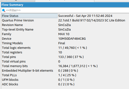

Hello! I have developed a FPGA software (NB: I'm not sure it can be called software, but anyway verilog code), about 2+ years ago. As it needed a sinewave, I used coefficients stored in a double a...
- 2 years agoCan't be answered without seeing the complete design. Most likely two bits are redundant (not driving actual logic).

2 years agoHello!
Thanks for your reply. Indeed, what you describe is right. I wanted to build a complete new version
from scratch because of beginner problems in my very first project, beginner that I still am.
I oversimplified the project. It used to make a linear interpolation between 2 consecutive samples,
caculating in 18 bits, then rendering the result in 16. An for a start, I was using only one of the
samples (i.e. no interpolation), therefore the 2 last bits were not used at all.
Thanks a lot for your help, it works now, and the compilation reports 18432 bits used, which is
exactly 18 * 1024. The numbers match, now.
