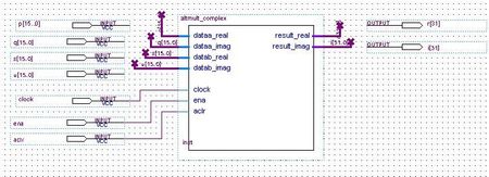

6 years ago275024 : width mismatch in ports
Hey all, I'm trying to implement ALTMULT_COMPLEX for complex numbers, However, when I came to implement the circuit, it shows that all input sizes are mismatch. Can you please help with that? an im...
6 years agoOh, if you're going to not directly connect the I/O to the bus wires of altmult_complex, you need to add bus wires to the I/O and name them appropriately. The tool thinks your I/O are all single bit. I/O naming in the schematic editor is separate from internal signal naming. Your I/O objects are right next to the block. Why not just connect them directly?

6 years agoI did, i connected them directly but got the same message again.
