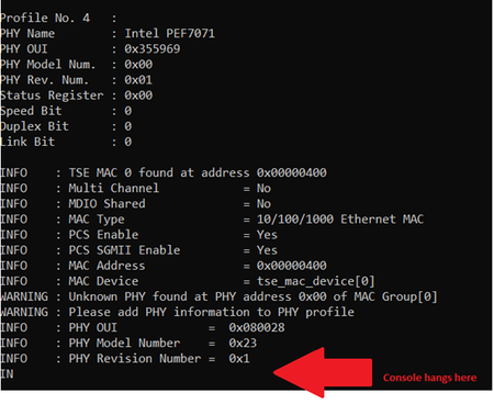

Why Nios II Simple Socket Server design example terminal stop before mapping PHY to tse_mac_device

1) May I know the Simple Socket Server design example that you are using? Could you kindly attach the link here.
2) May I also know the Quartus version you are using for your Simple Socket Server example? As there are some version of Quartus that does not support the simple socket server design.
3) I have here a KDB that might be related to your issue for your reference: https://www.intel.com/content/www/us/en/support/programmable/articles/000086010.html
4) You may also refer to the user guide for more information to interact with the Simple Socket Server on NIOS II console: https://www.intel.com/content/www/us/en/docs/programmable/683574/21-3/interacting-with-the-nios-ii-simple.html
