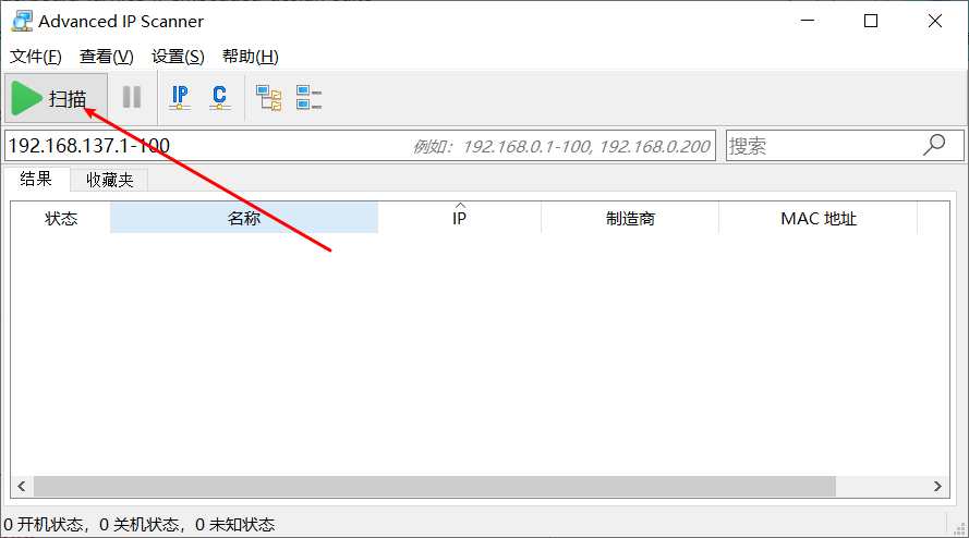

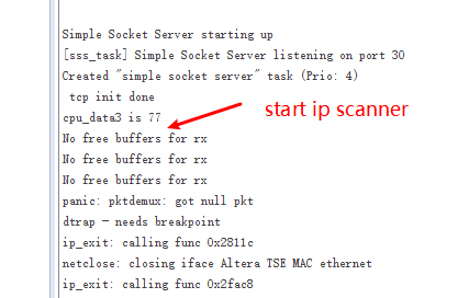

When IP scanning, nios will crash
my project is ucos simple soket server
ip is Triple-Speed Ethernet ip
wireshark : arp
how to solve this bug!!! Please help me!!wuuuu...

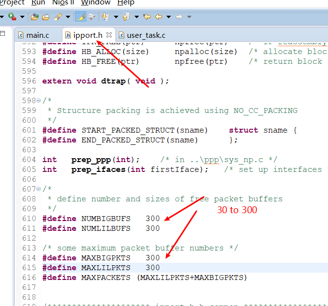

ok!!,this problem is solve!!!!
Two days of interrogation on chatGPT
chatGPT is god!

if i set maxarps is 512,it still not work
