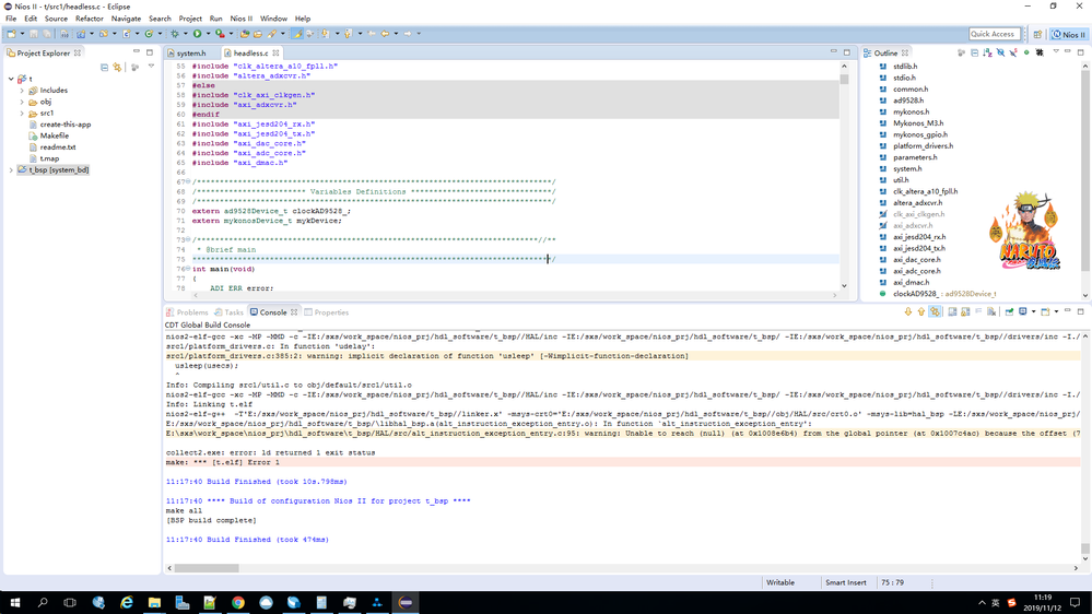

6 years agowarning: Unable to reach (null) (at 0x00091c78) from the global pointer (at 0x0007e4d0) because the offset (79784) is out of the allowed range, -32678 to 32767.
which I always get when developing applications with NIOS II ().
The initial use of DDR3 as the starting point for the program was changed to RAM due to project requirements

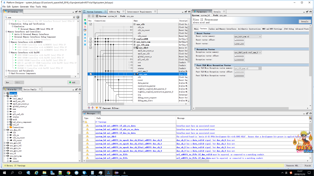

Always Intel recommends to set the exception vector to On-chip ram to get a better performance of the interrupts actions.
I see you are using the on-chip as a reset but DDR as exception. I recommend you to follow the following document:
https://www.intel.com/content/dam/www/programmable/us/en/pdfs/literature/hb/nios2/edh_ed_handbook.pdf#page=%20218
