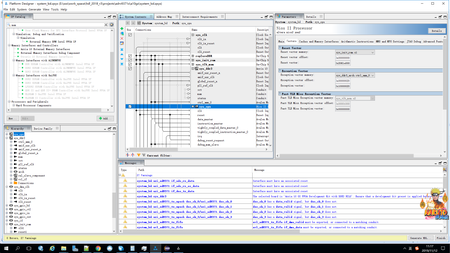

6 years agowarning: Unable to reach (null) (at 0x00091c78) from the global pointer (at 0x0007e4d0) because the offset (79784) is out of the allowed range, -32678 to 32767.
which I always get when developing applications with NIOS II (). The initial use of DDR3 as the starting point for the program was changed to RAM due to project requirements
Ahmed_H_Intel1
6 years agoHi,
Always Intel recommends to set the exception vector to On-chip ram to get a better performance of the interrupts actions.
I see you are using the on-chip as a reset but DDR as exception. I recommend you to follow the following document:
https://www.intel.com/content/dam/www/programmable/us/en/pdfs/literature/hb/nios2/edh_ed_handbook.pdf#page=%20218
