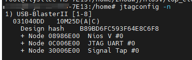

Thank you for the detailed guidance. I ran the command as suggested and have attached a screenshot of the output for your reference. Could you please take a look and advise on the next steps based on what you see? I appreciate your help.
Hi
From the screenshot you shared we could see the NiosV is being brought up.
You could not start downloading you application file (.elf) to the device using the command "niosv-download <path to elf>"
Once completed you could see the Nios V logs that are output to the jtag uart using the the command "juart-terminal"

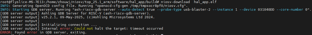

niosv-download download prompts the same error

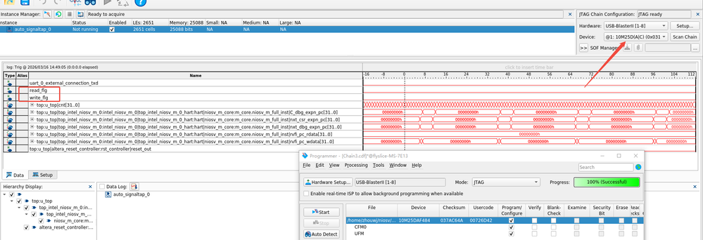

After the Riscfree download error occurred, we also tried other methods to start the niosv platform, that is, the 5.5.2. Niosv Processor application execute-In-Place from UFM described in the manual. This can solve the situation where the elf is larger than the available RAM, and when the elf changes, you only need to regenerate the pof.
However, after strictly following the hardware and software design procedures in 5.5.2.1 and 5.5.2.2, the Niosv serial output still has problems. Using Signal Tap to capture the niosv data_manager bus, we found that wvalid and rvalid were never pulled high.- tehjingy_Altera5 months ago

For the error seen that could not halt.
Try reducing the jtag frequency with the command and try again:
jtagconfig --setparam <cable number> JtagClock <frequency><unit prefix>
