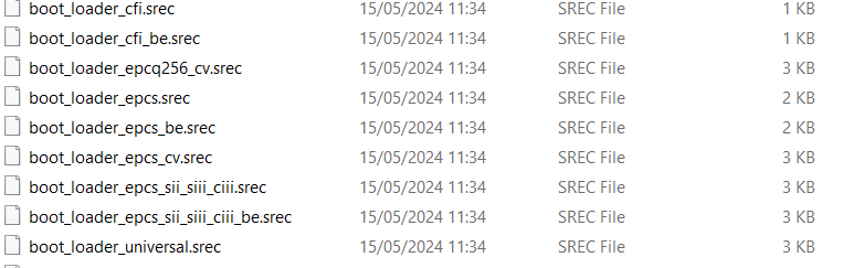

Interestingly I notice that Nios 2 had a number of bootloaders . I used the one for CFI flash.
NiosV only has one for each version.Its not clear whether any of them support QSPI.
