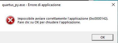

I'm encountering a problem with the Nios V suite, in particolar I'm not able to start the shell (niosv-shell.exe) and the RiscFree IDE. Operating system is Windows 10 and version of the tools is the latest (Quartus Prime Pro 23.3).
I'm getting an application error 0xc0000142: I've already reinstalled the whole suite two times, sometimes the program start, sometimes not. Did any other have a similar issue?

This might be related to windows DLL mismatch problem. I hope you can try to reregister all DLL files using command which is based on step here - https://thegeekpage.com/how-to-solve-application-error-0xc0000142-in-windows-10/
