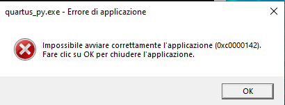

2 years agoniosv-shell and riscfree don't start - application error
Hello, I'm encountering a problem with the Nios V suite, in particolar I'm not able to start the shell (niosv-shell.exe) and the RiscFree IDE. Operating system is Windows 10 and version of the tools...

2 years agoHi,
This might be related to windows DLL mismatch problem. I hope you can try to reregister all DLL files using command which is based on step here - https://thegeekpage.com/how-to-solve-application-error-0xc0000142-in-windows-10/
