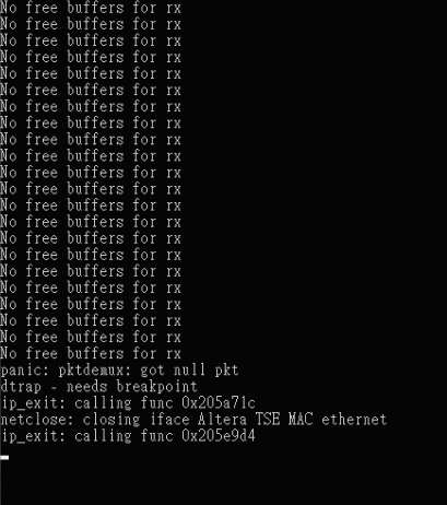

My Simple Socket Server design will stop running and print out messages like "No free buffers for rx", panic....
Below is the messages, lost communication and control after that.
Just wondering if there's any suggestions on how to debug or solve this problem.
Thank you!

    Can you try to transmit larger data packet, and reduce the number of data transfer.

      But I just leave this system connect to intranet without sending any messages, then it happened..
