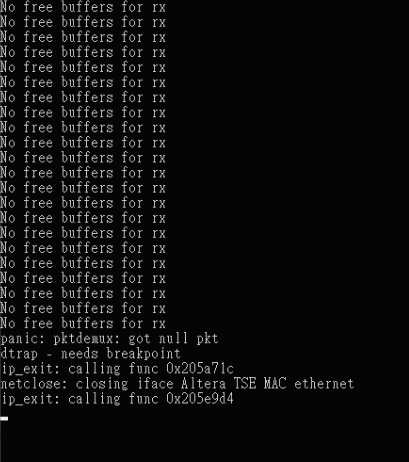

Hi all,
I am not sure if anyone had similar experience.
My Simple Socket Server design will stop running and print out messages like "No free buffers for rx", panic....
Below is the messages,...
EricMunYew_C_Intel
4 years agoCan you try to transmit larger data packet, and reduce the number of data transfer.
- JLee254 years ago
Contributor
Thank you for the suggestion..
But I just leave this system connect to intranet without sending any messages, then it happened..
