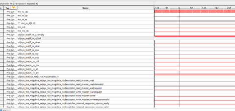

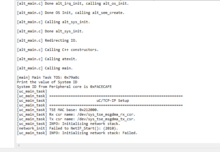

I am learning the simple socket server design on Cyclone 10 GX.
For unknown reason, the initialization process stopped with the error code (2010),
It's the TSE with DP83848.
The signals on MDIO and MDC is working.
Therefore I would like to know how to debug this issue.
Thank you.
