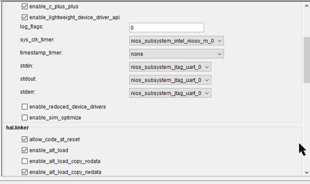

NIOS V: Systick based timeouts not available when using internal timer
