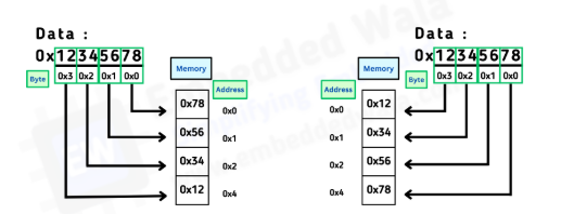

I don't understand what you are saying about the typo about endianess
This graphic illustrates endianness, and it matches what is in words above. Please explain your concern:
Sue
- ZhiqiangLiang
https://www.intel.com/content/www/us/en/docs/programmable/683689/current/endianness.html
Sorry, I misunderstood the logic. I withdraw my comments.
- SueC_Altera
Contributor
No worries. I'm glad we got it sorted out!
