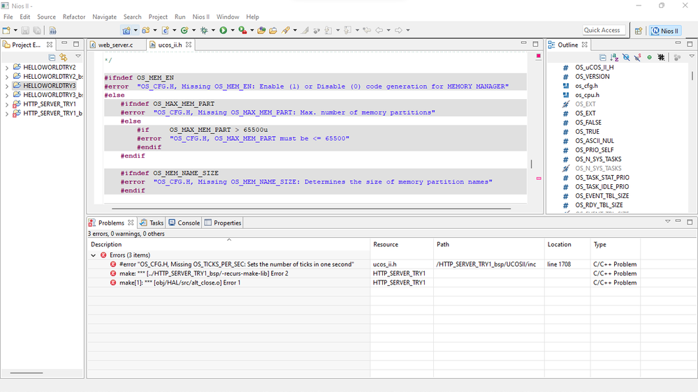

NIOS II IDE error
If anyone has gotten such error, Can you let me know how you fixed it?

    Need a system timer in your SOPC project.
    • In SOPC builder, you'll find the timer in the library: Peripherals > Interval timer
    • Set a timeout period of 10ms and select the Simple periodic interrupt preset.
    • Then regenerate your SOPC system and recompile Quartus project.
    • Make sure that the system clock inside OS_CFG.h file points to 10ms timing.
    • I don't remember if the bsp settings are automatically adjusted. If not you may need to update them and select the timer you just created as system timer before recompiling the software.
    Sheng
    p/s: If any answer from community or Intel support are helpful, please feel free to mark as solution and give Kudos.

      I tried the solution but I got into different issue. Maybe there is issue in my design that i am not aware of. I attached a photo of my platform designer picture of the system. Is there something I am missing?

    My Ethernet soft core uses CFI_flash. The EXT_FLASH_BASE in network_utilities.c in simple_socket_server_rgmii should be CFI_FLASH_BASE, the compilation can pass
    I notice the core you use in SOPC is cti_FLASH. May be you have to change both EXT_FLASH_BASE and EXT_FLASH_NAME in network_utilities.c to cti_FLASH_BASE and cti_FLASH_NAME respectively.
    Sheng
