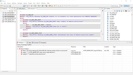

ntahoturi5922
4 years agoI tried the solution but I got into different issue. Maybe there is issue in my design that i am not aware of. I attached a photo of my platform designer picture of the system. Is there something I am missing?
