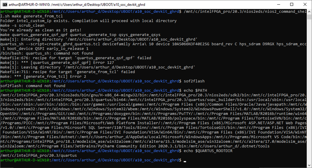

I am using Win10 WSL1 and run "Nios II Command Shell.bat" from my 'C:\intelfpga_pro\20.3\nios2eds' and when I prompt commands from Quartus I receive "command not found":
- 'sof2flash' - command not found
- ' make generate_fro_tcl' - /bin/bash: quartus_sh: command not found
The $PATH is ok, $QUARTUS_ROOTDIR ok. Please see the screen capture:

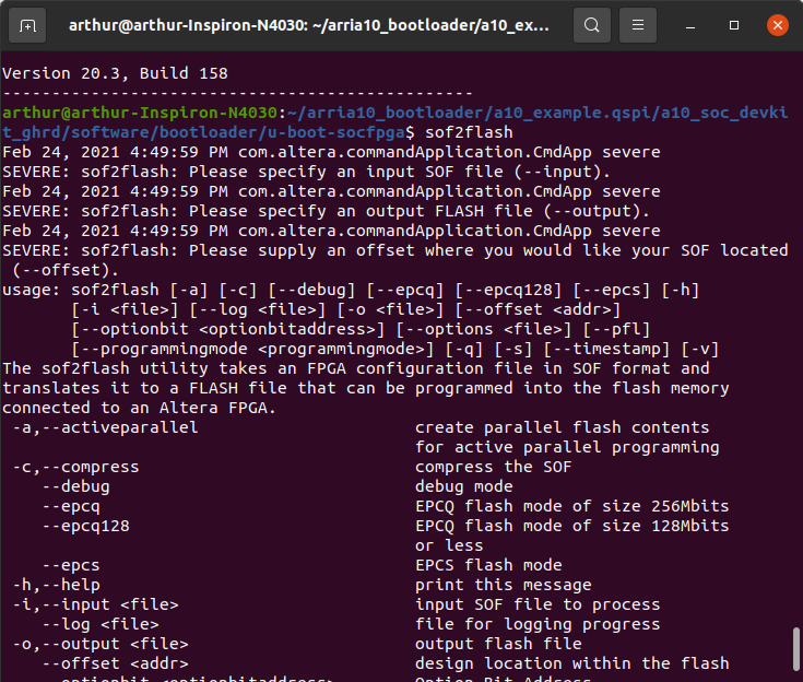

BUT if I do the same with From my Linux machine - it works:

Hi @Arthur_Davidov,
Thank you for posting in Intel community forum, hope this message find you well and apologies for the delayed in response.
The environment setup seems correct, as for the command to execute the sof2flash in window, please do try adding a .exe at the back to see if that works. (i.e. sof2flash.exe)Best Wishes
