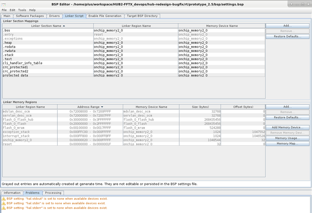

Hi, Recently I got an old Arria V design to update. It is in Quartus II 15.0 containing the following main components (in Qsys design): NIOS II soft processor 2x UniPHY DDR3 RAM controller (soft ...

- I still need to review the linker script settings, so kindly share the screenshot with me. if possible, share the settings.bsp file.
- I also need to know which JTAG UART driver is being used—whether it is the standard driver or the fast driver. This can be checked in the BSP Editor under the General settings.
- Additionally, there is a warning in the BSP Editor indicating that .stdin, .stdout, and .stderr are not assigned to an output device. Although a JTAG UART instance appears to be present in the design, the standard I/O streams are currently set to “none.” I would recommend to update the BSP settings to redirect these streams to the JTAG UART.

- Unfortunately I could not attach the bsp file. But here are the linker script settings:

- I updated but situation still did not change.
