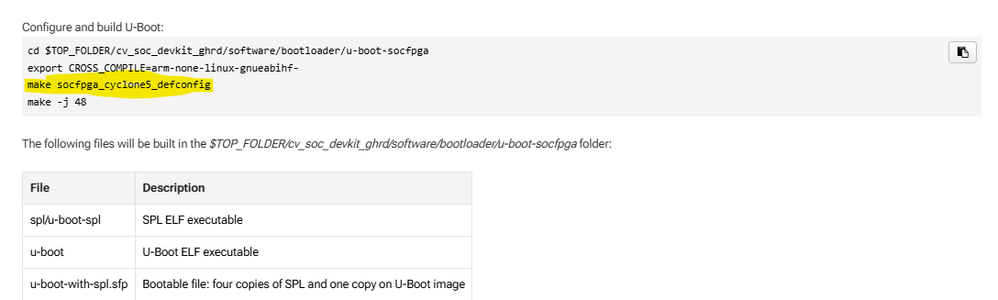

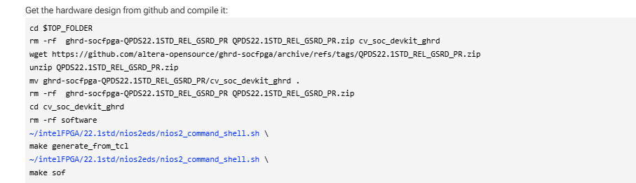

For the steps , you could refer to the cyclone V devkit building bootloader guide (https://www.rocketboards.org/foswiki/Documentation/BuildingBootloaderCycloneVAndArria10) even though you have DE1 - SoC board.
Only a few things that you need to take note of:
1. You don't need to use the ghrd here because this is Altera dev kit . Instead you should download the ghrd example from Terasic website for DE1- SoC (under CD image if not mistaken) and build accordingly
2. To build the uboot, you need to specify which board you're building (highlighted in yellow) . I saw that you already have the uboot build, do you have other files specified in the guide
eg( make socfpga_de1_soc_defconfig , also remember to edit or port the changes from the dts/dtb file you have into socfpga_cyclone5_de1_soc.dts (and dtb))
