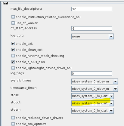

When you create the BSP, look in the "Main" tab to see what is selected for stdout.
In the screenshot below, I have the lw_uart selected. When jtag_uart is also present, the BSP creator arbitrarily picks one of them and you have to change it to the desired uart before clicking the "Generate BSP" button.
If the jtag_uart is the only UART present in the hardware, it should be selected automatically.
