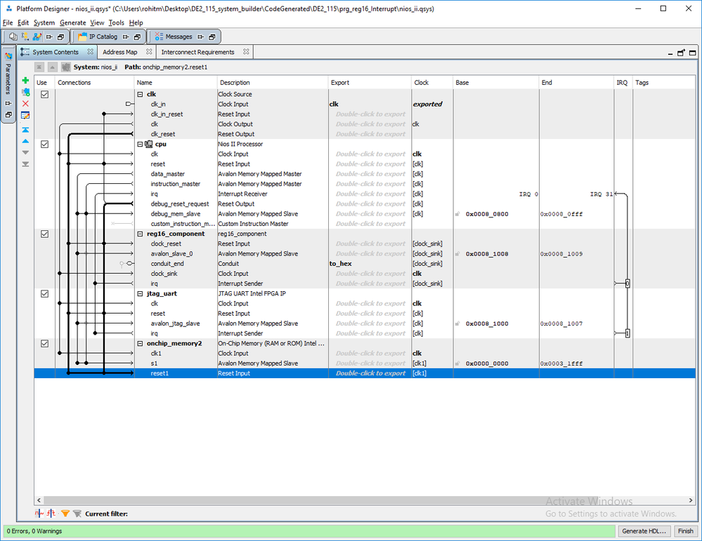

We have created Avalon MM Slave with AV Interrupt Interface using Qsys. The IRQ sender from the Slave device (form AV Interrupt Interface ) was connected to IRQ Receiver of NIOS II as shown in attached image.

alt_ic_isr_register(REG16_COMPONENT_IRQ_INTERRUPT_CONTROLLER_ID, REG16_COMPONENT_IRQ, (alt_isr_func)handle_interrupt, 0, 0x0);Now whenever the interrupt is generated, ISR is not invoked.
Any suggestions.

PIO components also generate interrupts. There are several tutorials you can find on the Net to see how interrupts are implemented. By exchanging the PIO component with your component, or the pio nios-II democode to your code, you can narrow down your search.
