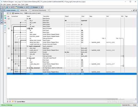

7 years agoISR Not invoked for custom Avalon Interrupt Interface.
Dear All, We have created Avalon MM Slave with AV Interrupt Interface using Qsys. The IRQ sender from the Slave device (form AV Interrupt Interface ) was connected to IRQ Receiver of NIOS II as show...

7 years agoHi,
I recommend using Vector Interrupt Controller VIC to interrupt and replicate one of the reference designs in INTEL's design store.
Here:
