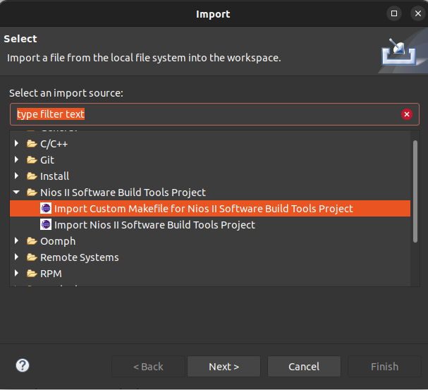

3- From File -> Import -> Nios II Software Build Tools Project -> Import Custom Makefile for Nios II Software Build Tools Project
4- Select the Project location. Do this twice to include the APP and BSP folders.

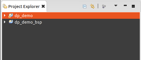

5- You should see the included directories inside the Project Explorer
