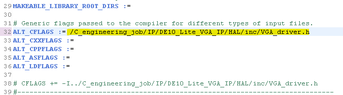

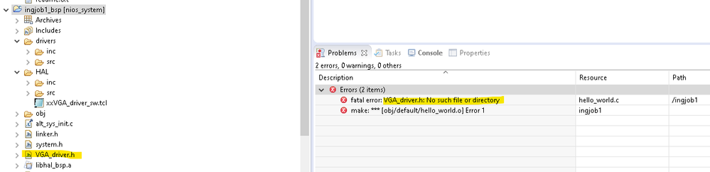

When I tries to include the driver, #include <VGA_driver.h> , in the top of the main .c file (Hello world), I got the error message: hello_world.c:37:24: fatal error: VGA_driver.h: No such file or directory. When I writes the link in the .tcl file (or c-file), to the VGA driver, it expects it to be in the project folder (in the inc folder with the other .h files).
I have tried to add the link address into the makefile (but the error remains the same).
I have also included the driver in the project as a file and as a link, (but the error remains the same).

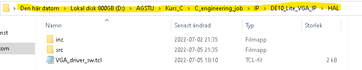

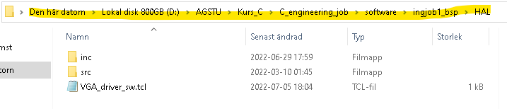

The project folder is:
The customer wants the driver in this directory instead:
VGA_driver_sw.tcl below:
