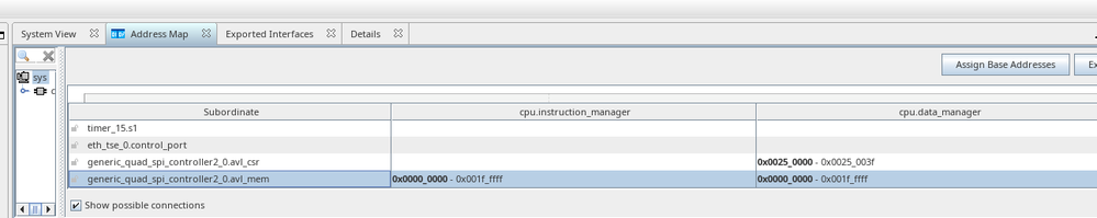

Hi
The Base and End Address of the GSFI could be found under the Address Map view in Platform Designer.
With the screenshot above the start and end address will be 0x0 to 0x1f_ffff
