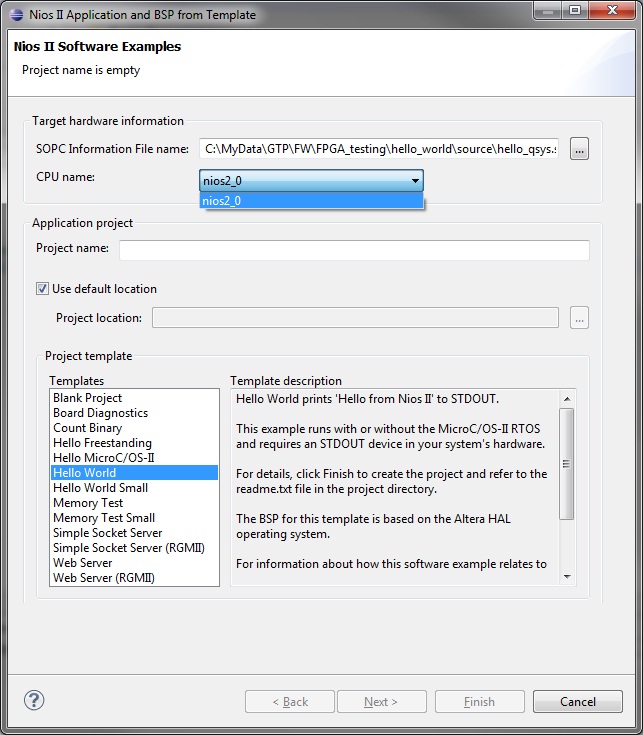

    I don't have a hierarchical project to look at but I would guess that when you create the project in the SBT, you choose the sopcinfo file for the top level and then the processor you'd like to link to the project. That way you can target different processors in the same design.
  • Altera_Forum's avatar
    Altera_Forum
    When you create a new application and BSP template, you get a screen like the one attached. After you target the sopcinfo file, it gives a list of processors. I only have one but I expect you'll see them all.

    Wooooooooooow!I get successful!
    Thank you very much. Thanks for your aid.

    All of the CPUs should be showing up assuming you are generating the top level system which contains the CPUs below it or within it.
    There seems to be some confusion about what you need to generate. Think of this like verilog or VHDL, you compile a top level module and all the children are compiled too. The same goes for Qsys, if you generate the top level system then all of the children (and their children, and so on....) are generated as well.
