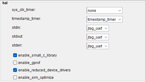

      Sorry for the confusion, the "interval timer" was renamed by me as a "timestamp_timer" in the design, you may find it from the attached .sopcinfo file, so it was connected as a peripheral in Nios II. At the moment, BSP project has been successfully generated by typing "nios2-bsp-generate-files --bsp-dir . --settings settings.bsp" at the relevant directory via Nios II command shell, but BSP still cannot be automatically generated by clicking "generate BSP" at the sub-menu of "Nios II" in Eclipse.
      Hence, generate BSP could be partially resolved at present, as the programme in C can be downlaoded and executed in Nios II. However, some new issues were encountered recently. As I mentioned that I was trying to measure the code running time by using an interval timer (i.e., "timestamp_timer" in my design), but it seems that my programme "froze"/stucked at "alt_timestamp_start()" when executing the code. Please see part of my test code below:

      In this method, I also enabled timestamp_timer in BSP editor, please see the screen shot below:
      Having realised time stamp method may not work properly, I tried another method to measure the code running time, which is almost the same as this one: https://community.intel.com/t5/Nios-V-II-Embedded-Design-Suite/How-to-calculate-the-time-for-running-the-code-in-Nios-II-and/m-p/1430160 (BTW, the peripheral "interval timer" (i.e., timestamp_timer) connection in my design is exactly the same as the one mentioned in this link). Since both of the methods have to utilise the "interval timer". Hence, I changed my test code as follows:

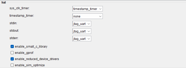

      Further, in this second method, I enabled sys_clk_timer in BSP editor, since the programme is counting system clock cycles...
      However, the second method is returning 0 clocks from printf(), in other words, the value of "t" doesn't change...
      There should be something wrong in the design settings (perhaps BSP settings) or something wrong about the timestamp_timer connections. Could you please help to check it? Thank you very much in advance.

    • XintingXue's avatar
      XintingXue
      After a correct HAL setting upon the timestamp timer, I finally made it to read programme execution time. Many thanks for your help!
