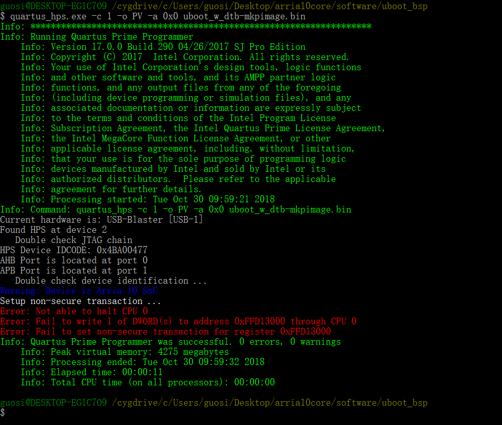

I tried a lot of ways to download uboot to QSPI FLASH through the directive of quartus_hps. However, there will be errors.
Error:Not able to halt CPU 0
Error:Fail to write 1 of DWORD(s) to address 0xFFD13000 through CPU 0
Error:Fail to set non-secure transcation for register 0xFFD13000
What should I do?

Thanks for your reply,I have learned the tutorial refer to https://rocketboards.org/foswiki/Documentation/A10Gsrd170QspiBoot

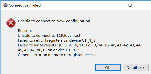

but I did not solve this problem.I designed a board using ARRIA10 SOC.When I download uboot to QSPI FLASH,The error information is shown in the figure1.Then I debug bootloader using ARM DS-5.The error information is shown in the figure2. What should I do?

Were you able to make any progress on this? I'm getting the very same responses, trying to load U-Boot to a QSPI device with quartus_hps. The FPGA has configured properly from it's own QSPI device. The HPS has its QSPI device where U-Boot should load from. I have confirmed BSEL is pulled up and down to BSEL[2:0] = 0x6 (1.8V QSPI).
