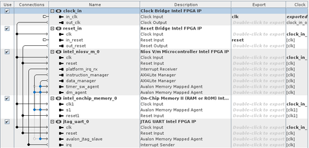

2 years agoIt seems like I forgot to assign the clock PIN on Arria 10 GX. Besides, when I utilized Nios V/M on Arria 10 downloaded from the design store, simply changing the part and assignment did not work. Therefore, I configured the Platform Designer from scratch. Anyway, it now works.
Thank you for your response.
