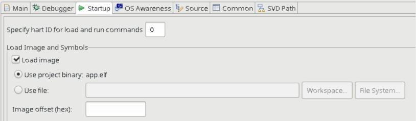

Alternatively there is a workaround given by engineering team previously whereby you can try performing Debug with boot from serial flash by “uncheck” the Load image option.
The rest of the settings is still the same.Thanks
Kian
- Paul83
Hi Kian,
I try your advise and it seems it works. But even I checked the Load image box again, there is no problem
Thanks for your help.
Paul
