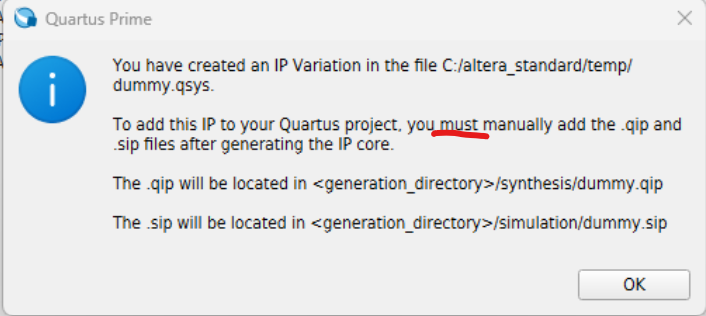

  • Hi Barry,
    Rather than Adding QSYS into project, please add QIP into the project. From 25.1std, the tool supports QIP only due to a change in Quartus compiler.
    The tool also prompts with message below.
    You may find a qip file located in the same folder of qsys system top level hdl file under project directory liking this.
    Hope this is helpful.

      • Archer_Altera's avatar
        Archer_Altera
        Hi Barry,
