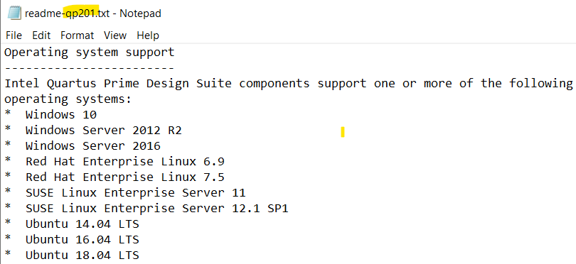

  • Hi,
    Attached here is a screenshot of the supported Ubuntu OS for the Quartus version 20.4pro that you are using.
    As it does not support 20.04, you may have to upgrade the Quartus version.

    I just checked for the Quartus version 20.1 pro that you are using, it does not support Ubuntu OS 20.04.
    You may have to upgrade to a newer Quartus version, which is 20.4pro onwards that supports the Ubuntu OS that you are using.
    Once you have upgraded the Quartus version and perform the steps from the previous link on Linux Installation, the errors should be eliminated.
    Hope to hear on your feedback.

  • KellyJialin_Goh's avatar
    KellyJialin_Goh
    Thank you.
    Kelly
  • Anu_Jayan's avatar
    Anu_Jayan
    Hi
    I have upgraded the Quartus version to 20.4 pro. And now its working. Thank you.
