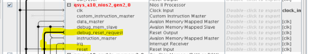

Since you get the processor reset failed error so we suggesting these three possibilities you can look and check.
1. Clock bridge IP frequency is incorrect (between QSYS & actual clock)
2. Reset bridge IP settings (Most common one is the Active Low)
3. Connection between processor debug_reset_request to processor reset
