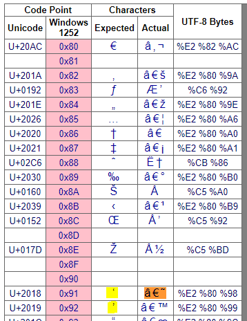

      To your question: What's with the wierd "‘’" directory name?!?!?
      I found this table:
      Looks like an empty path described by those two characters '' gets passed to mkdir. Maybe wslpath gets confused by relative paths, I dont know.
      Thank you all for your help and kornev_online for your solution! I would have never solved this problem.
