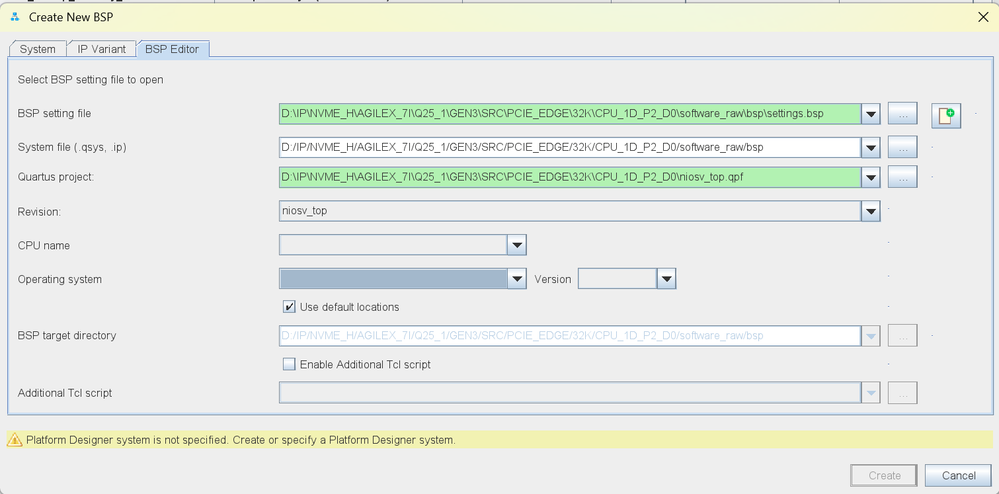

Cannot create a BSP with NIOSV on Quartus 2025.1
Hello Support,
When I want to create a BSP from a simple NIOSV system I got the following message :
Platform Designer is not specified...
I have attached the Quartus project.
It works on Quartus 2024.3
Thanks for help.
Serge

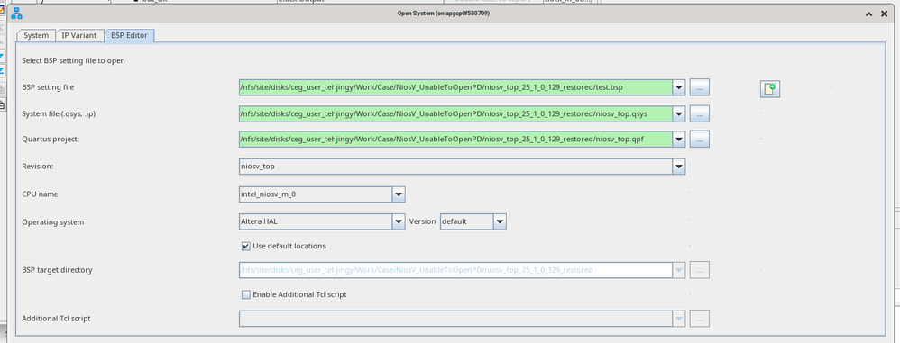

    Hi
    You would need to select the .qsys file under the "System File" field.
    Please refer to the screenshot below:

    • Serge93's avatar
      Serge93
      Hello Jingyang Teh,
      Thank you.
      It works.
      You can close the case.
      Serge
