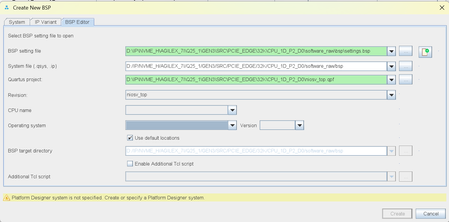

1 year agoCannot create a BSP with NIOSV on Quartus 2025.1
Hello Support, When I want to create a BSP from a simple NIOSV system I got the following message : Platform Designer is not specified... I have attached the Quartus project. It works on Qu...

1 year agoHi
You would need to select the .qsys file under the "System File" field.
Please refer to the screenshot below:

1 year agoHello Jingyang Teh,
Thank you.
It works.
You can close the case.
