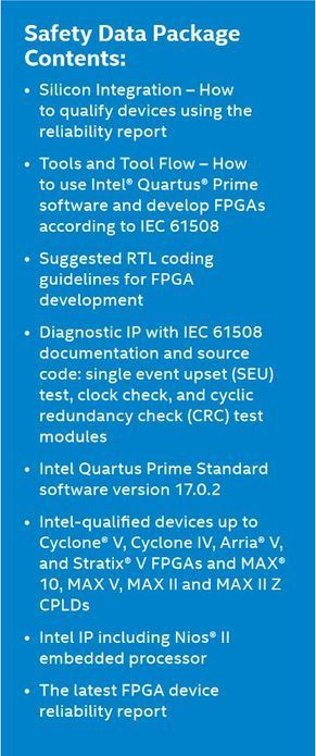

      Hello
      thank you very much for your answer. However i made a mistake in my original post. It's not the Pro but the Standard version that is delivered with the safety data package:
      I assume the fyler is just outdated and you get the newest available version with the package, which also enables you to use NiosV.
      Now I have an additional question regarding licensing Quartus in general. It is noted on the website that there is currently only 1 ordering code for Standard and Pro version. Why is that? And is this the correct ordering number "SW-ONE-QUARTUS "?
      How do you select between node-locked and floating?
      I assume when you renew the safety data package via "IPR-ABG-SAFETYDP5" you also recieve the latest Quartus Standard version, but there was no option to chose between node-locked or floating during our offer.
      Thank you very much for your time.

    With the SW-ONE-Quartus license, customers gain access to both Intel Quartus (Standard or Pro) and Questa-Intel FPGA Edition (paid). Customers have the option to select either a Floating or Fixed license type through the Self-Service Licensing Center.
    If you need ordering number "SW-ONE-QUARTUS "costs/purchase, can go thru our distributor. Please find the contact for our sales and distributor near you from link below:
    https://www.intel.com/content/www/us/en/partner/where-to-buy/overview.html
