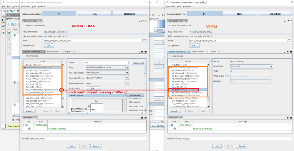

WHY is "txs burstcount" missing in Avalon-MM DMA interface w/ PCIe HIP (Arria 10) ?
hi all,
we met a performance issue on Arria10 mSGDMA Avalon-MM master(32bit data width) interconnect to PCIE HIP's Avalon-MM (w/ DMA) slave (txs 32bit).
For "mSGDMA_writing_to PCIE AVMM(w/ DMA) TXS" operation, data transfer performance is good.
But for revere "mSGDMA_reading_from PCIE AVMM(w/ DMA) TXS" direction, data transfer is very slow, we monitored the "txs waitrequest" signal to de-asserted to activate , found found the reading consumes much more clock cycles (16 x) than writing operation. This blocks us for a long time yet.
I just compare Avalon-MM interface signals between PCIE HIP's "AVMM ( with DMA)" vs PCIE HIP's "AVMM" variant, then we found the "txs burstcount" signal is missing in PCIE HIP's "AVMM ( with DMA)" interface , while it really exist in PCIE HIP's "AVMM" interface, as following pic:
so my question is : waht's the reason of this difference ? Does this "txs burstcount" miss in AVMM-DMA interface would affect the reading (burst) opearion from mSGDMA AValon-MM Master to PCIE HIP TXS (avalon-mm slave) ?
Appreciate helps & advices if any. Thanks
