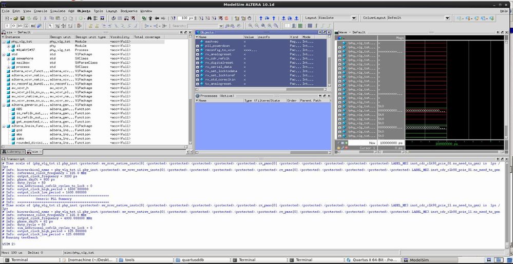

- Vicky1
Alex,
Apologies for the late response. I tried with Quartus II 13.0sp1 (web edition) and Cyclone V Native PHY Tranceiver for a Cyclone V. & simulated successfully with Modelsim-Altera 10.1d Starter Edition.
check screen shots.
Best Regards
