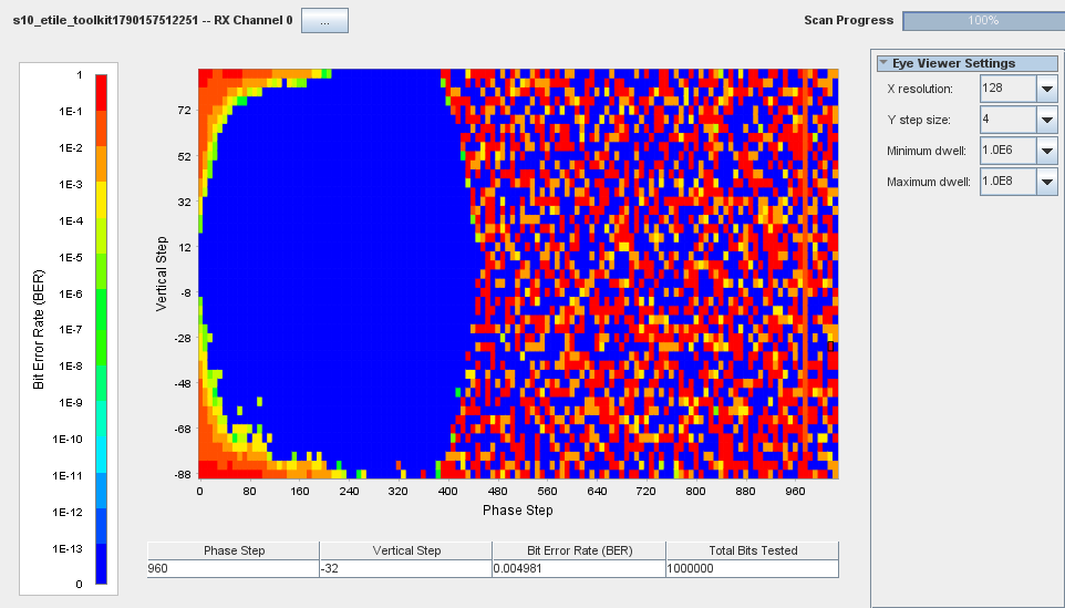

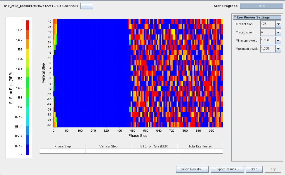

Inconsistent Eyes with S10 E-tile Transceiver.
Hi Support and Community. Why am I obtaining eyes sticking to the left instead of the middle?
Quartus Prime Pro 26.1
Stratix 10 TX SI
Signal : NRZ @1.4Gbps
Channel: External Loopback (Tx+ to Rx+ Rx- via single ended to differential converter, Tx- terminated with 50 Ohms)
Eye h/w: ~90/~500
PMA: Settings are on default (after initial adaptation)
