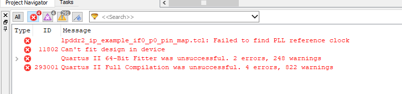

Why can PLL + LPDDR2 compile success in Quartus 17.1, but fail in 13.1?
Device:5CEBA4U15I7N
The reference clk of lpddr2​ is connected to the output of pll, the project can compile success in 17.1 but failed in 13.1.
Error: Failed to find PLL reference clock.
1 Reply
  • BoonT_Intel's avatar
    BoonT_Intel
    Hi sir,
    Probably it is due to an issue for that old version. The 13.1 obsolete quartus version is obsoleted. Please use newer version.
