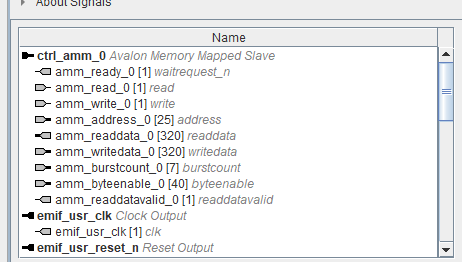

I have tried connecting together the EMIF IP to the NIOS II processor within Platform Designer but they just complain about the interfaces not aligning. I have managed to get the EMIF IP to talk to a HDL module, but is it necessary to create a custom module to interface between the NIOS II and the SDRAM or is there some pre-existing IP that can connect the NIOS II and SDRAM that I am not aware of?

The problem is that the mismatch isn't from the address span but from the datawidths themselves. The EMIF controller has a width of 320 bits, whilst the NIOS2 can only handle 32 bits.

The design is based on the example design from the EMIF IP Parameter Editor provided with the Cyclone 10 GX dev kit which comes with a width of 320 and also a burst interface, see attached image. I assume the 320 width comes because of the hardware requirements of DDR3. I can deal with the address span with the Address Span expander IP, but I cannot just hookup the NIOS to the example design because of the bursting and the difference in data width. I have tried looking for example designs for the Cyclone 10 GX with the NIOS connected to DDR3, but to no success. It's looking like I am going to need build a custom instruction module to get them to communicate.
