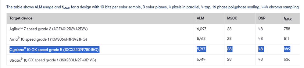

  • Hi Wincent_Altera​ ,
      Thank you.
    Do have any idea about the performance difference between C10 GX I5 vs I6?
    The performance I mean is fmax.
