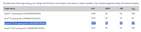

Hi JLee25
For the fmax detail between grade 5 and grade 6 , you may refer to our device datasheetHope that clarified,
