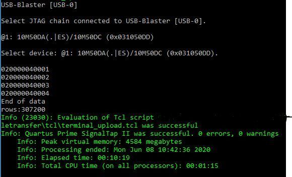

I'm using Virtual JTAG mega function along with tcl script on Quartus_stp to upload this file into the SDRAM.
The upload speed is about 6kbps.So it takes about between 10 to 11 minutes to upload the picture file.

Find tcl script used for the file transfer below
#upload file to SDRAM using VJTAG
global usbblaster_name
global test_device
foreach hardware_name [get_hardware_names] {
puts $hardware_name
if { [string match "USB-Blaster*" $hardware_name] } {
set usbblaster_name $hardware_name
puts "\nSelect JTAG chain connected to $usbblaster_name.\n"
foreach device_name [get_device_names -hardware_name $usbblaster_name] {
puts $device_name
if { [string match "@1*" $device_name] } {
set test_device $device_name
puts "\nSelect device: $test_device.\n";
#open_device -hardware_name $usbblaster_name -device_name $test_device
#########decimal to binary string##############
proc dec2bin n {
incr n 0
set r {}
while {$n > 0} {
set r [expr {$n & 1}]$r
set n [expr {$n >> 1}]
return $r
#########end decimal to binary string###########
##############3 MAX 10 lite##########################
open_device -hardware_name {USB-Blaster [USB-0]} -device_name {@1: 10M50DA(.|ES)/10M50DC (0x031050DD)}
###########################TEST#################################
for {set i 0} {$i < 0} {incr i} {
set ln [format %08s [dec2bin $i]]
device_lock -timeout 10000
device_virtual_ir_shift -instance_index 0 -ir_value 3 -no_captured_ir_value
puts "writing=$ln"
device_virtual_dr_shift -dr_value 3deaf4321 -instance_index 0 -length 35 -no_captured_dr_value -value_in_hex
device_virtual_ir_shift -instance_index 0 -ir_value 0 -no_captured_ir_value
device_unlock
after 100
##########################END TEST##############################
########################File transfer module###############################
#set fname "C:\\vga1short.hex"
#set fname "C:\\vga1.hex"
set fname "C:\\vga2.hex"
#set fname "C:\\secuence.hex"
set file [open $fname r]
set num_row 0
set segment 0
#while { $num_row <1024 && [gets $file line]>= 0 } {
while { [gets $file line]>= 0 } {
set segment_data [string range $line 1 12]
set EOF_len [string length $line]
if { $segment_data =="020000040001" | $segment_data =="020000040002" | $segment_data =="020000040003" | $segment_data =="020000040004" } {
if { $segment_data =="020000040001" } {
set segment 1
} elseif { $segment_data =="020000040002" } {
set segment 2
} elseif { $segment_data =="020000040003" } {
set segment 3
} elseif { $segment_data =="020000040004" } {
set segment 4
#incr segment
puts $segment_data
} elseif { $EOF_len<15} {
puts "End of data"
} else {
incr num_row
set address [string range $line 3 6]
set data [string range $line 9 12]
#puts "address:$segment$address : $data"
##################### JTAG TRANSFER #######################
set ln $segment$address$data
#set ln $data
set data_length [string length $ln]
#puts "writing=$ln"
device_virtual_dr_shift -dr_value $ln -instance_index 0 -length 35 -no_captured_dr_value -value_in_hex
device_unlock
#after 1000
##################### END JTAG TRANSFER #######################
puts "rows:$num_row"
close $file
########################End File transfer module###############################
close_device
