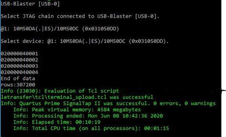

6 years agoVirtual JTAG Mega function transfer speed is about 6kbps. Is there any other IP with a higher speed ?
I'm using DE10-Lite Board to project a rgb picture on a 480 by 640 VGA screen. The picture size 460800 bytes. So 12 times 480*640 pixels. Due to limited resources on DE-10 LITE platform I have to u...
- 5 years agoGot it.
In the meantime I came accros an article using jtag_atlantic dll with C# and using JtagUART IP. Doqnload happens in seconds.
