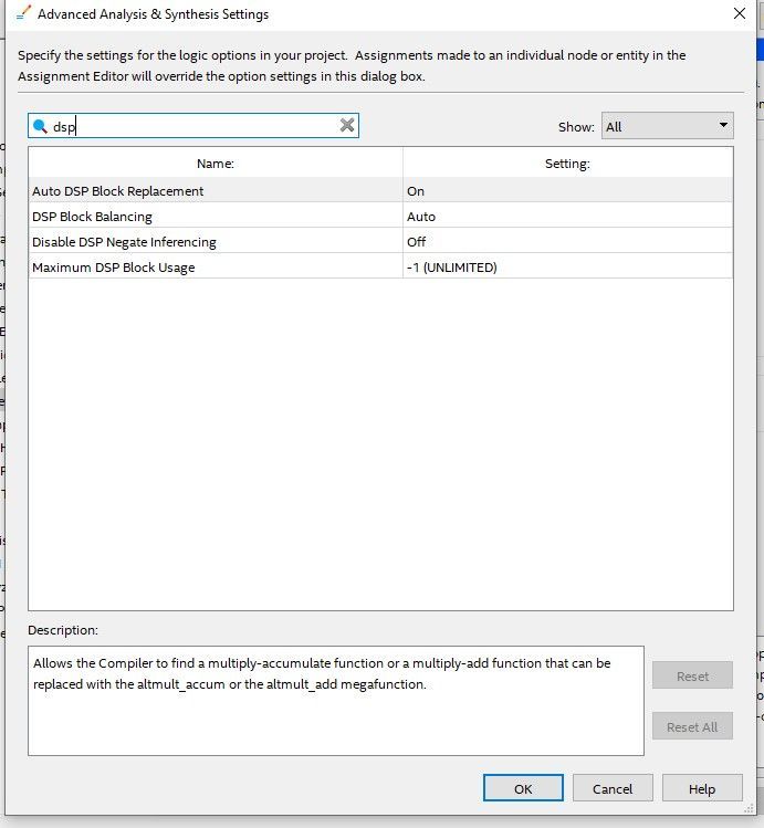

Hi, Does the FFT IP come from Intel Quartus Prime? Have you check your settings in assignment-> settings -> compiler settings -> advance for syn and fit for all the related dsp setting had been turn on? Thanks- VenkateshSathar
yes I am talking about FFT IP from Intel quartus software only.
Those are the current settings right now we are using, is that correct?
will that setting make some of the DSPs freely available in fpga to be used as logic elements for FFT IP?
- KennyT_altera
That is the only setting you have. How much percent you have used for your DSP block? Did you get fitter error?
you can try to turn off the auto DSP block replacement if you want your DSP to be place in LAB but not in the DSP block. One Lab consist of 2 ALM, if your dsp logic does not put in the DSP block, it will put in the LAB.

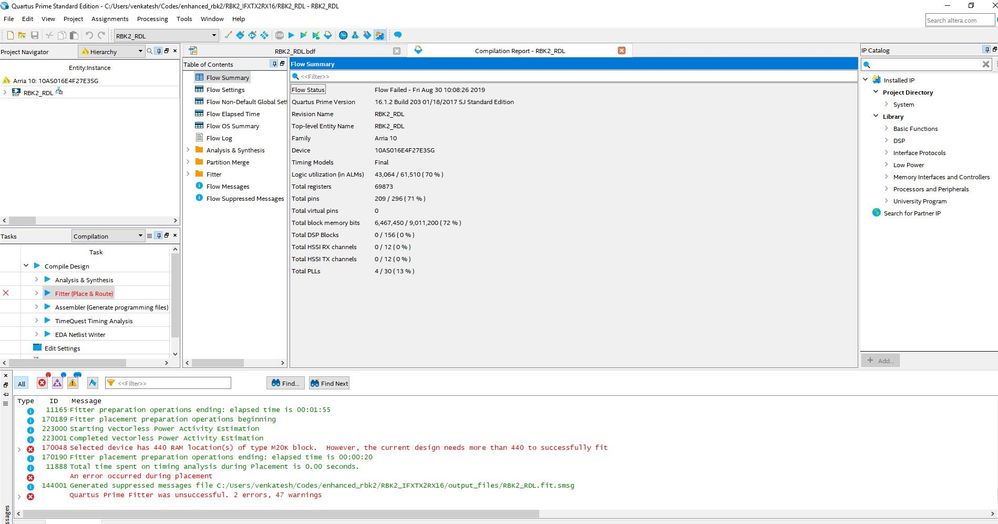

Resources usage summary report also added you can see.
Now I am getting a different problem.
- None of the dsps getting consumed for fft ip in the design and all ALMS only consuming
- Even though 72% of M20K used , it is saying that fitter can't run as it requires more than 440 M20K.
I am using quartus 16.1.2
Why like this what's wrong in settings?
anything more to set and correct..?😏 😬

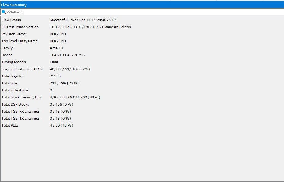

I looked in the PDF 16-32, that is telling about the option of DSP balancing when ALMs are not available how to use DSP blocks as slices, but my case is different right now for me whatever ALMs and DSPs block conusmption mentioned in FFT User guide are not matching with the current consumption.
As in the datasheet/user guide it is mentioned that DSP blocks will be consumed but in the actual scenario ALMs are getting consumed where I require ALMs for my other logic blocks to develop. So, I want the FFT IPs I added in my project I want DSP blocks for computation/multiplication logic to be consumed instead of ALMs.
My question is why that is not happening for the above synthesis settings i gave previously. To make it happen what to do?

Still As I told ALMs only getting consumed instead of DSPs . I just want to know that procedure only to force tool to consume DSPs for the respective logics atleast instead of ALMs. I don't see my clock in which I am going to operate is that much a big problem because I am using only 100MHz.

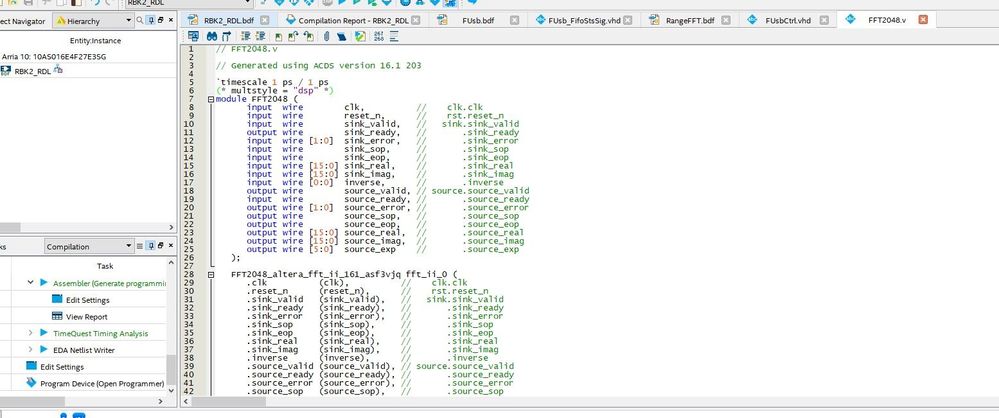

yeah. Understood. but since it is a standard fft ip and i added that in a bdf. in which verilog file i should add this attribute?
i see in online you can apply this attribute to the verilog code. but you know when we deal with schematic view and bdf and standard ips where is the scope for verilog file to add this ?
still i tried to add this at the verilog file top module file generated by qsys of the ip. No DSPs are consumed after this trying also. refered the attribute syntax from the following link https://www.intel.com/content/www/us/en/programmable/quartushelp/17.0/hdl/vhdl/vhdl_file_dir_multstyle.htm

What you can do is create a wrapper to wrap around this FFT2048 and with the top level name FFT2048_no_DSP and another name with FFT2048_with_DSP. After creating this two wrapper, you can create bdf out of it and use it to your bdf.
Since I had very long did not touch on bdf, i remember seeing customer use attribute in the bdf itself. But I can't remember how they have do it.
We dont really encourage user to use BDF anymore, we encourage user to use verilog and vhdl code. As it is really not that hard to used.
- VenkateshSathar
what ever i have messaged about the usage is like using that attribute in a wrapper kind of code only. But still you can see 0% dsps used.
