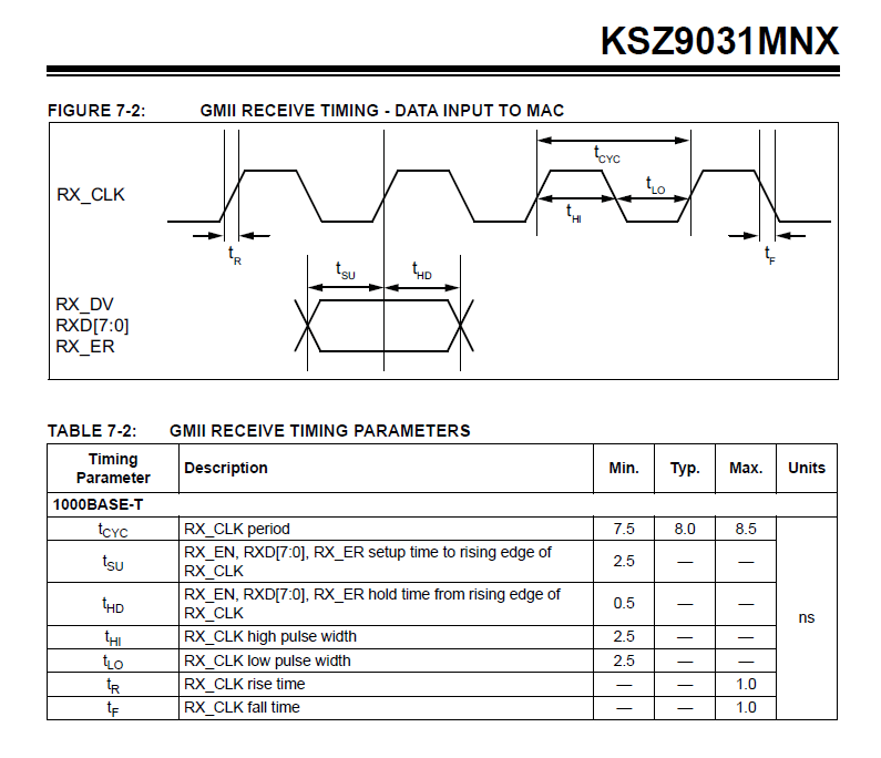

For the KSZ9031MNX PHY the GMII receive timing - data input to MAC is given as follows:
I understand that the phy applies the data on the falling rx_clock edge. Correct?
Or do I have to take care of this delay myself for the incoming data in the FPGA?
I have tried around with the following instructions and different delay times in the sdc file of the project. There seems to be an influence on the behaviour described above, but maybe that's just coincidence, because the problem still occurs in a synthesis-dependent way.
set_input_delay -clock rx_clk -rise 2.000 eth_rx_dv
set_input_delay -clock rx_clk -rise 2.000 eth_rx_err
set_input_delay -clock rx_clk -rise 2.000 eth_rxd[*]
I found the sdc file attached (altera_eth_tse_fifoles_mac.sdc) in the directory of the TSE IP core, but I don't quite understand what it does and whether it has an effect on my problem.
Unfortunately, there is very little information about timing in the TSE IP Core documentation.
Is there a more detailed instruction for this somewhere?
What does the timing have to look like so that the TSE IP Core reliably outputs the received data to the Avalon-ST bus?

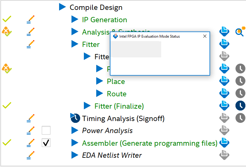

Found the cause:
The cause was the licence evaluation dialogue. The dialogue text was not readable on my computer (see figure below) and the window was often hidden behind other open windows.
So I sometimes closed the window and sometimes left it open because I couldn't see it.
When you close the window, the ip core no longer works. - But how can you tell if the dialogue is'nt labelled?I found the clue here:
community.intel.com/t5/FPGA-Intellectual-Property/TSE-MAC-catatonic/m-p/155152#M12528Fig. Evaluation dialogue
