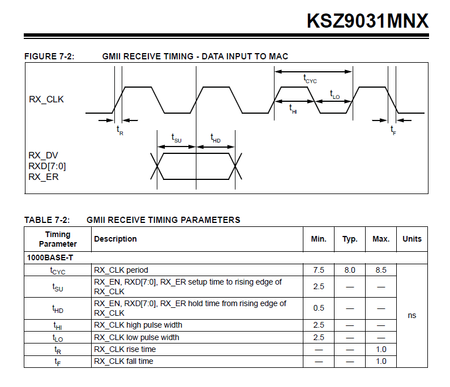

2 years agoTriple Speed Ethernet MII/GMII - Timing Issue
When I send a UDP Broadcast packet from the PC to the board, the packet is visible on the GMII RX lines coming from PHY. But data do only sporadically arrive on the Avalon-ST RX bus - see post TSE ...
